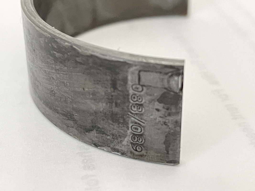

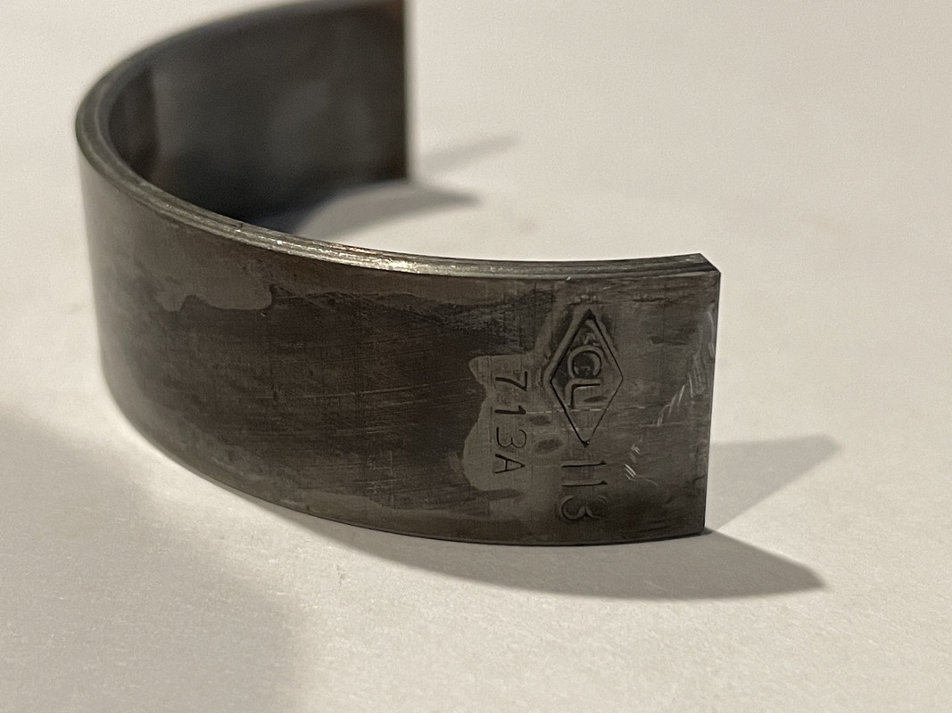

2011 E92 M3 6MT, 30.6k miles, 2nd owner, bought the car with 23.4k, religiously warmed up in my ownership properly and never revved past 3000 RPM until proper warm up.
Replaced with BE Bearings and BE ARP Bolts. Replaced them for peace of mind and budgeted the bearing cost prior to buying the car. Had shop do spark plugs, oil pan gasket, new motor mounts and rear differential fluid change while getting bearings replaced.
If shop put bearings in correct spots back in the cushion, the left should be the Top and right side is the Lower.
About typical wear for S65 LCI bearings (neither great nor terrible), I take it none show copper?

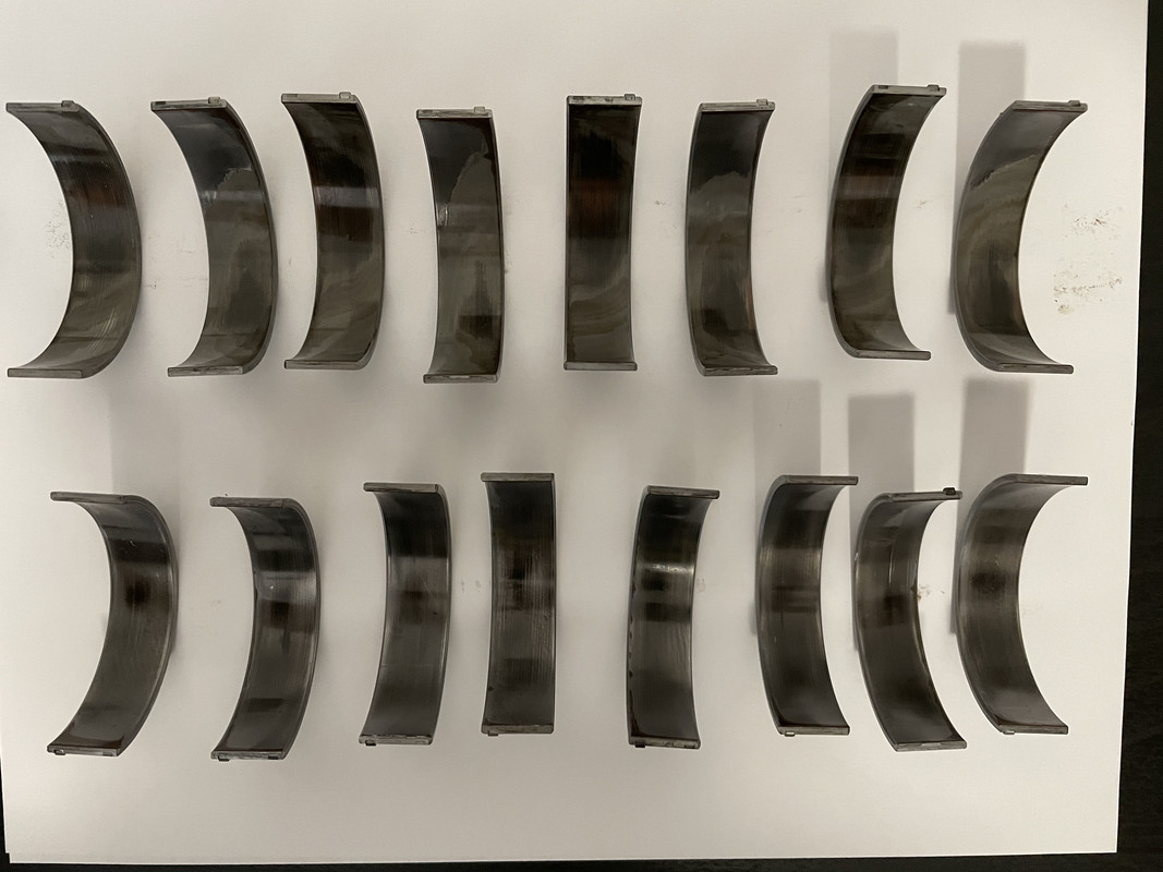

Here's mine. Taken out at 54k. Two owner car I've been religious about warmup but bought the car with 52k.
PO did a few track days with it.

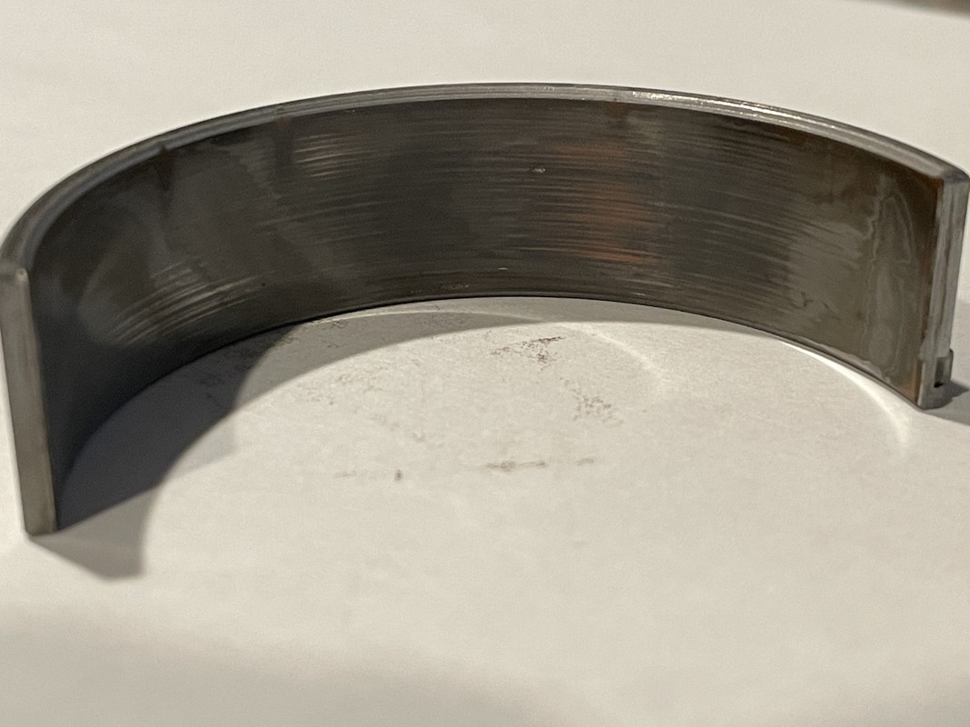

Heres a closeup of the top bearing in cylinder 1. You can see copper just starting to come through.
Bearings did not show as much wear as others and I could have gone longer before replacing in my opinion. But at least I can sleep better knowing they have been replaced.
Nah they were shot, not as bad as mine were, but showing copper is never right, the lead is meant to be their to protect the crank at starts and stops, and any debris that enters.
Good call on changing them anyway. OA worked for you (added your case to my sig thread).

Btw, do you fancy doing a couple of little experiments on a couple of your old shells for us? (if you still have them?).
81000 '08 with oil report
Post referenced by Assimilator1 in S65 Oil reports collation - does oil analysis work for tracking bearing wear? 02-26-2020
Assimilator1 wroteI still have them.
Ok, so the experiments I have in mind involve polishing one 1/2 of one shell, and rubbing down one 1/2 of another shell of your worst 2 shells.
And by one 1/2 I mean 1/2 of the length (not the width), like this.
For polishing I was thinking of using T-cut, or equivalent. For rubbing down I used emery paper, which was quite coarse (unfortunately I don't remember the grade, but I believe it was a medium grade), sandpaper should be fine to use too. No need to rub it down all the way to the end of the shell, just need to wear through the babbitt (silver layer) to the copper, across the shell.
The polishing is to see if the dark coloured spots in the middle of the bearing is wear &/or just some kind of oxidisation or ingrained carbon etc (so just trying to clean the shell).
The rubbing down is to see if the babbitt layer has been worn through.
As for which 2 shells, I was thinking 3rd one from the left and 2nd one from the right in the top left photo of yours. Do they look like the worst worn ones in person to you?

Assimilator1 wroteNot sure when I'll have free time but I could try and donate some time for science.Ok, so the experiments I have in mind involve polishing one 1/2 of one shell, and rubbing down one 1/2 of another shell of your worst 2 shells.

IamFODI wroteCopper traditionally contains lead. As required by EU mandate, all lead was to be removed from production bearings. As 702/703 bearings are mfg by Glyco, I believe these bearings utilize their CS-4 alloy substrate, although I've not seen it confirmed anywhere publicly. It's more like a bronze so will appear as a copper when cut/polished.
deansbimmer wroteBronze is a copper alloy.Copper traditionally contains lead. As required by EU mandate, all lead was to be removed from production bearings. As 702/703 bearings are mfg by Glyco, I believe these bearings utilize their CS-4 alloy substrate, although I've not seen it confirmed anywhere publicly. It's more like a bronze so will appear as a copper when cut/polished.
IamFODI wroteBronze is a copper alloy.
It comes in many forms as a component of many alloys, most of which containing lead. Glyco specifically developed their own CS-4 alloy for the purpose. This is one of the several reasons why you'll still see copper in oil analyses of 702/703 bearing engines. You just can't tell how severe the wear is since the bearing's wear layer is the same makeup as the rest of the engine.

Cyberdemon wroteThe emery paper I used was quite coarse, what you have might be just fine.Not sure when I'll have free time but I could try and donate some time for science.
I'll don't have any thing finer than like 240 grit sandpaper right now so it might require a trip to home depot.
